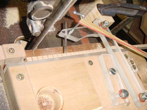

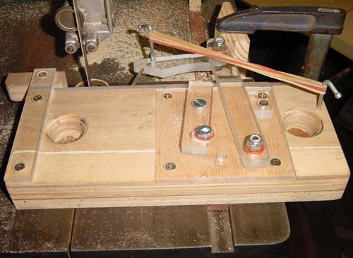

Inspired by Frank Ford of Frets.com and assisted by a comprehensive pictorial guide that was so generously put together and emailed to me back in January by Daniel Huskey, I have (finally) made myself a kerfing jig (or K-Sled as Daniel so aptly named it) for use on the bandsaw
I must say that I am really very happy with this easy to make and affective jig. With it one can cut any type of kerfing as fast as they can move the jig back and forth in the mitre slot of their saws table (or auxiliary table if your saw does not have a slot). Also, it is completely adjustable for both kerf spacing and depth.

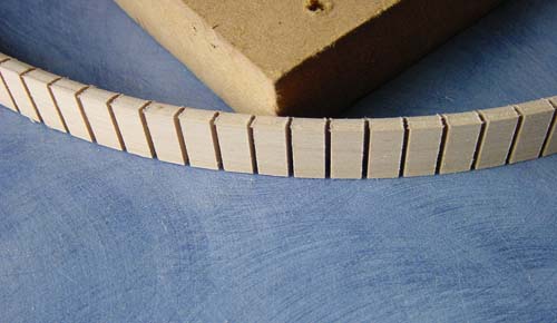

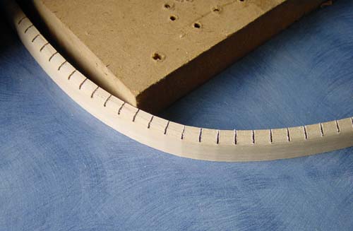

Here is some images of the reverse kerfing that I cut with this jig from some Tasmanian Oak

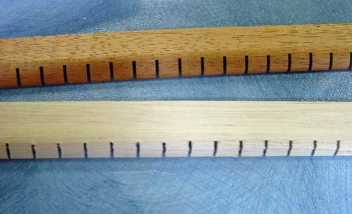

Here is a comparison between commercially available reverse kerfing in mahogany, and the stuff I made with the jig from Tassi Oak, you be the judge.
